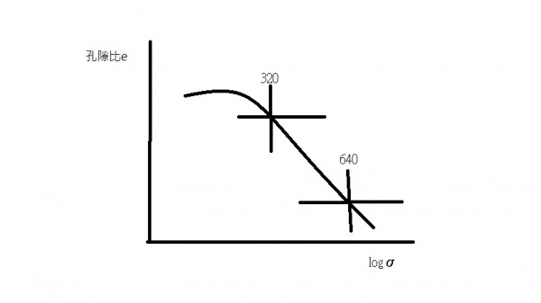

請問這張考卷的第二題的題目要怎麼畫成示意圖並求解??謝謝解答 :)) (XD)
第二題

Cc = (0.878-0.789)/log(640-320) = 0.0355
e = (0.878+0.789)/2 = 0.8335
(1)ΔH1 = 6*[0.0355/(1+0.8335)]*log(270/120) = 0.041m
(2)ΔH2 = 6*[0.0355/(1+0.8335)]*log(120/120) = 0m
(2)ΔH1 - ΔH2 = 4.1cm

附註:仔細看看孔隙比與對數σ數值實驗,所以我取640與320下去計算。
